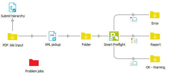

Flow elements and modules used for this case
Automating web to print
Pdf
Preparing jobs for quality control
The information in the XML file is picked up by the Metadata Module.
In this case, the XML contains
  • job number
  • trim page size (horizontal and vertical)
  • paper selection
The trim page size will be used in PitStop Server's Smart Preflight & Correction to verify that the job has the correct trim page size, and the paper selection will be used in a rule-based variable to determine the value for the ink coverage check.
In your production environment, this information can be expanded to include any useful production information, such as product type, color intent, quantities ordered, etc.
Metadata module
Receiving jobs
Switch detects incoming PDF files and XML job specification files that are placed on the server by the web-to-print system.
