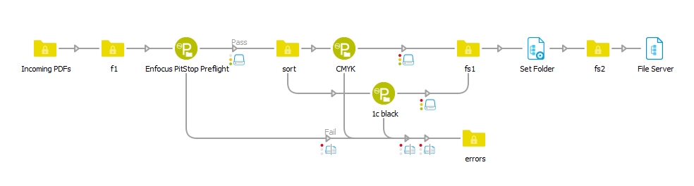

With this solution, Switch has PitStop Server seamlessly integrated in the workflow to standardize jobs prior to prepress:
  • Jobs enter the flow by being dropped into a folder watched by Switch.
  • Using a PitStop Server, a standard page geometry is applied to jobs to ensure consistent bleed and media boxes based on trim. Other PitStop Server actions could be applied to embed fonts, add slug lines, uniform page rotation, etc.
  • The flow directs files to CMYK or one-color black PitStop Server configurators to ensure colors are converted as expected.
  • Lastly, the flow sets the job folder paths to place them on the file server according to date, customer, job type, etc.
